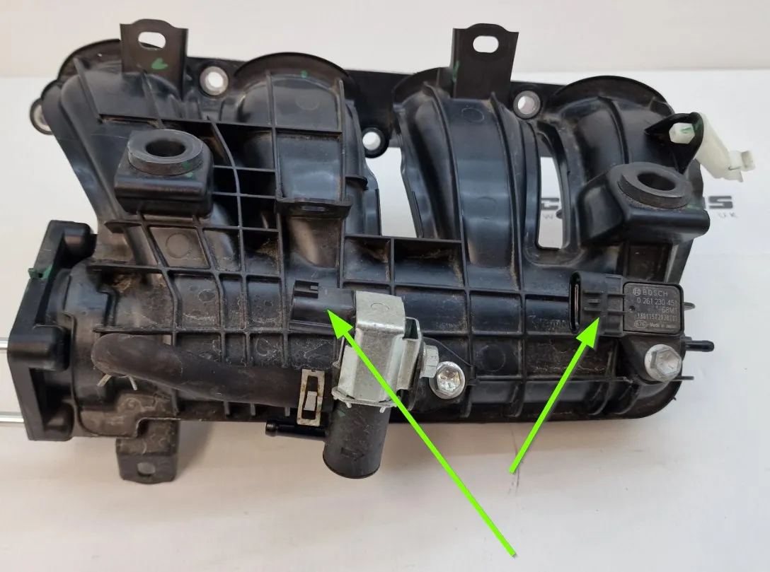

  • Has anyone tested by changing all sensors at the same time (MAP, MAF, Boost pressure,...)?
    I don't know what that thing in the middle is?
    edit: link not working
    the link doesn't work.
