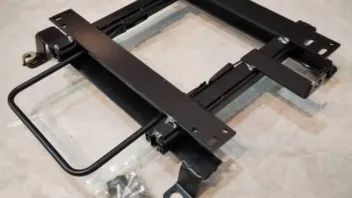

    https://rzcrewgarage.com/products/power…=18531147022433
    Unfortunately I can't tell if this one is the same as above one from the Amazon. There is a option for LEFT/RIGHT steering wheel.
    Probably there is also option for LEFT so you can lower both seat, just need direct contact to the manufacturer and ask for LEFT option.

    Mit dem ST-Gewindefahrwerk bekommst ihn laut Beschreibung um 50mm tiefer… evtl das mal anschauen?
    I dont think so:
    "Can be fitted on most reclinable aftermarket seats (Recaro, Bride, Sparco, OMP...) "
    They just say, it will be lower than the OEM seats.

    "Version L"
    https://item.rakuten.co.jp/auc-jimgmbh/s087l/
    https://store.shopping.yahoo.co.jp/unionproduce/mom-s087l-v01.html
    GB-S087L
    GB-S087R
    2019/ZC33S//KW/V3/Sparco/AssettoGara/GY/215/40/17

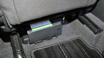

    Would this also work in the hybrid version?

    I guess it's the same so it should fit. Not sure if you can modify the seat mounting without papers (TÜV).

    I am asking because of the hardware under the seat in the hybrid Swift Sport. Paperwork is indeed another thing to look at. Thanks!

    Beim Hybrid ist der 48V-12V DC/DC Converter unterm Fahrersitz. Könnte natürlich sein, dass der Platz nicht reicht.

    Not much space between the battery and the seat.¯\_(ツ)_/¯
