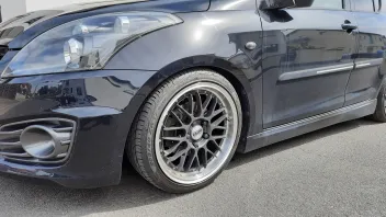

    All set up. Arch measurement I’m down about 33.5cm at the front and 34.5 at the rear. Measurement off the jacking points showing about level 13.5cm front and 14mm on the rear.
    Some adjustment to do but car feels good with those figures.
